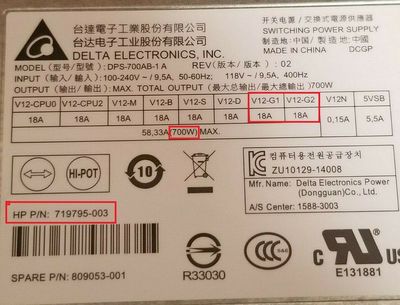

I'm not familiar with z440's power supply and for your application it's critically important
most power supplies nowadays are what's called "single rail" meaning the supplies total output is available on each power connector
"multirail" power supplies are made using separate sub section power units that when totaled up equal the total supplies wattage the problem here is that each power subsection has a fixed wattage
look on the side of the HP supply and see what wattage each connector is able to supply

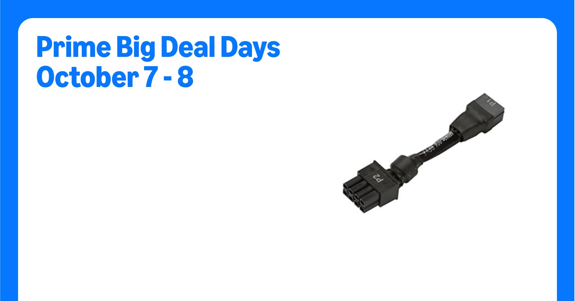

the 2080 TI is not a issue just make sure to use QUALITY 6 to 8 GPU adapters the HP one is the gold standard and highly recommended
https://www.amazon.com/HP-Power-Supply-Adapter-N1G35AA/dp/B011Z74OGW

Oh yeah i have the 700w power supply and i think it's a multi rail psu?
Each 6 pin power connector can supply 12 volts at 18 amps which is 216 watts so thats gonna be fine. the 2080ti should work with no questions asked i guess.

The Z440 motherboard is basically the Z640 motherboard with a few parts not installed on the existing unused traces, and the Z440 700W PSU has two of those HP above-ATX-standards supplemental power supply cables. You can really soup these up. The 6-to-8 pin HP adapter DGroves showed is the best.
The Z440 also has 2 full power PCIe Gen3 x16 PCIe slots separated enough so that you can get double width video cards in each, and they provide 75 added watts up into the cards from each slot.
18A x 12VDC = 216W, +75W from below = 291W total. More than enough total to power the 2080Ti, which wants 250W. HP makes a beefed up single 6 pin-to two 6-pin adapter so I believe you could use that plus the power from the slot to get what you need. You might need two 6 to 8 adapters depending on what the card wants to see plugged in to its two top 8-hole sockets.
