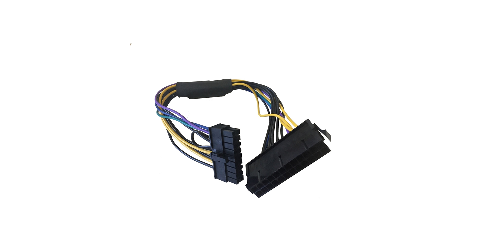

i believe the z420 uses the same design power supply as the z620/820 systems which are multi rail supplies instead of the single rail designs found on most new consumer power supplies
early z420 600 watt supplies DID have 2 6 pin GPU connectors, but hp changed the supply to one that only has one in later systems and supplied a high quality dual 6 pin adapter where required
due to this it's possible to overload a single rail (GPU in your case) while being under the max wattage on the others
even though the z420 uses a non standard supply of 400 watt and a optional 600 watt unit (18 pins) there are adapters to convert it to a standard 24pin ATX supply
https://www.amazon.com/11-inch-24-Pin-18-Pin-Adapter-Workstation/dp/B071NL4VK2
https://www.youtube.com/watch?v=Mm6OnJMqydQ&feature=youtu.be
https://greenpcgamers.forumbee.com/t/36skbf/hp-z420-gaming-computer-and-other-upgrades
if you go this route, a name brand QUALITY supply is required DO NOT USE THOSE CHEAP 600 watt $15/1000 watt $50 supplies!!
stick with coolermaster/antec/silverstone and the like and i recommend a 650 watt unit
