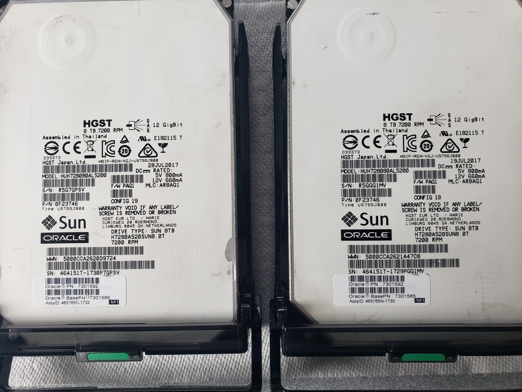

Hello again @DGroves. I would like to ask you a few questions regarding the Adaptec 71605 card that you referred to in your reply. I have not committed to the card as yet.
I fooled myself (or just simply did not do my due diligence) when I decided to purchase 2x HGST 8TB SAS Drives. See pic for drive details:
HGST 8TB
I recall you having said that "the z820 has a LSI low end single chip "mustang" controller chip that lacks onboard cpu for x/or calculations, no cache and no battery backup as such it can only really do raid 0/1 it's raid 5 capable but this mode is extremely slow"
This would probably explain why the Z820's RAID configuration utility does not recognize either of the drives. Or, they are just not compatible with the machine or the LSI 2308 Controller at all.
If I do purchase the Adaptec 71605 is there any way of knowing that I will not run into the very same issue. Perhaps, there exists an Adaptec compatability guide that I can refer to. Again, your time and assistance is greatly appreciated. Peter
DGroves has helped me learn about the built-in Windows utility Diskpart. It has been valuable. In the past I've salvaged multi-TB odd server HDDs one at a time using Diskpart from within Windows running it from an elevated CMD (CMD run as admin). I'd consider putting one of those drives in a spare drive bay and check in Computer Management under Disk Management if you can see it. If you can see it there you likely can use Diskpart to clean it of old odd server OS bits and use Diskpart to GPT partition it. Those will take some time to clean and configure if you can see them. I then do a long-type NTFS format with default settings otherwise once they have been GPT partitioned. The long-type format maps out bad sectors. I have a back room old HP xw workstation running W10Pro64 set aside for this purpose (and other boring things).
Peter, he will know much more about what to do on this issue than me.
