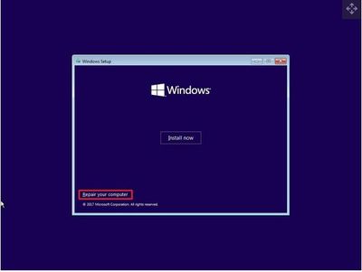

Assuming the USB flash drive is booted you will see the opening screen
2025-05-17 07_32_06-Windows 10 _Repair your computer_ _Reset this PC_ Screens - Microsoft Community .jpg
Click next - lower right corner.  Then this should show up
2024-09-02 06_36_45-How to use Startup Repair to fix boot problems with Windows 10 _ Windows Central.jpg
From this screen either pick "Repair this computer" in the lower left, for the tools, or click "Install now" from the center.
