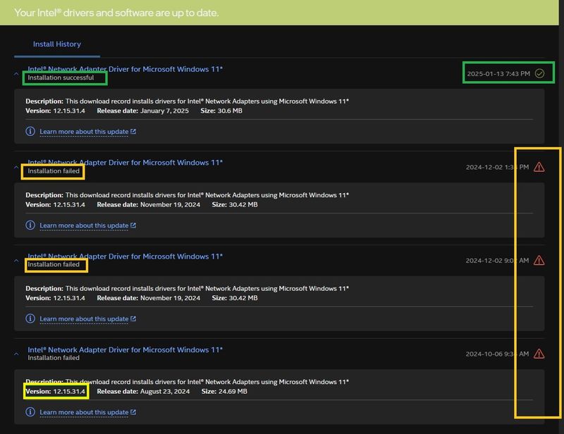

On multiple newer and older HP workstations and even some older business class HP PCs such at the E8300 and P6300 (all W11 24H2 upgraded) the installer that Intel DSA provided failed. The pic below shows one example of three DSA fails, and then success after I ran that Dell updater (which worked for all of them):
Top success after Dell updater run...Top success after Dell updater run...
