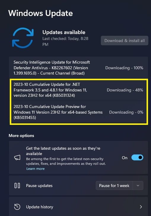

I simply downloaded the W11 23H2 installer from Microsoft, "mounted" it on a workstation, and copied out all of the components as the method describes. Using the same small .dll substitution as was used in the method earlier the result was a folder containing the single modification. The Setup.exe in that folder was used to launch the process, and it proceeded as before, doing an in-place upgrade on this Z400 v2, saving all files, folders, and apps rather than doing a clean install (which is another option). This install was then able to be updated using Windows Update, and 3 pictures below show the progress and system ID changes.

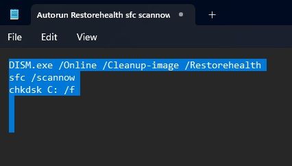

4. I do pretty extensive cleanup after these OS upgrades using the built in Disk Cleanup utility, and then use its Tools tab for disk error checking and optimization as the last step of that part. I also developed a 3-in-1 method I then use to autorun 3 sequential added built in W10/W11 utilities via a copy/paste from a small saved .txt file shown below. Run exactly this via an elevated CMD (CMD run as an administrator):
DISM.exe /Online /Cleanup-image /Restorehealth
sfc /scannow
chkdsk C: /f
NOTE: It is essential to add several returns as shown below starting at the end of the last line and to include those in your copy/paste... otherwise the auto-shift to the next utility won't work properly. After you copy all that you just right-click in the already open elevated CMD window somewhere near the cursor to auto-paste it in, and it should start automatically running all 3 in sequence. Handy. Then you can choose to do the checkdisk third step by answering Y if prompted, exit CMD, and do a restart.
Add several returns and include those...

Here are a few pics showing the W11 23H2 upgrade and then the automatic upgrade of that via Windows Update:
Upgrade W11 22H2 to 23H2
Windows Update offerings thereafter
