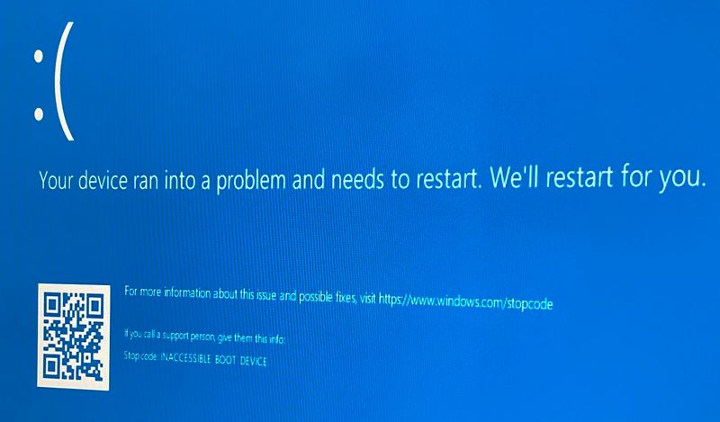

I've got another project to work on instead. I've had some issues identical to what I saw with my initial Predator difficulties, but with Z620 builds. I believe there are specific storage controller drivers that let a ZTD G1 work in ZX20 workstations, and some that do not. This came up due to me wanting to clone a perfect SATA-SSD build onto a ZTD G1 (having a known-good HP AHCI-controller M.2 stick in place) in one of my Z620s.  The same type of blue screen crash occurred with the same time delay as I saw in the Predator project years ago. I then captured a system image from an almost identical Z620 that boots fine under W10 from a ZTD G1 boot drive. I cloned that onto the second ZTD G1, and that build then could drive my Z620.
I'll post on that in about a week, and here is the blue screen crash I solved for the Z600/Predator under W7 and expect to solve for the ZX20 workstations/HP AHCI-controller M.2 sticks to reliably allow ZTD G1 booting:
