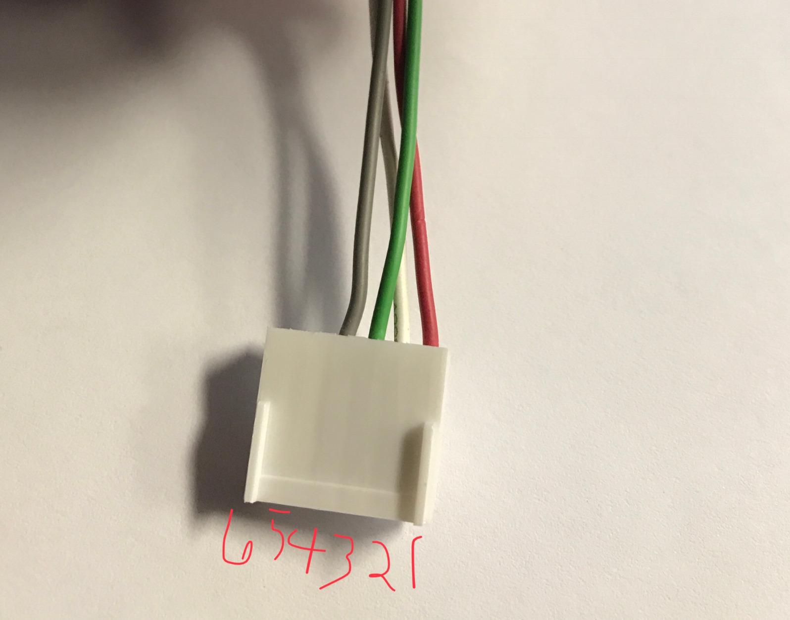

12-20-2017 05:25 AM
Hi i've bought en adapter which You suggested and it do not works with Z240 without modiffications
However even after modiffications it will just give you en 12V power on motherboard with issue of whole time spinning all fans what even can just because motherboard have power.
For modifikation you have to remake en plug. In place of green wire you have to put yellow and yellow in place where was green before replacement. I've been trying with other wires but it seems to that them do not have to be connected because them do not affect anything.
As i said i got problem with constant power on my motherboard even when my system is shutted down so all fans wil work annyway. For now the only solution for this for me is to switch off whole power supply.
Here is photo of my adapter which i was moddified and my description is to this plug
So modiffication one more time just switch green and yellow wire places. At least it works for me.
