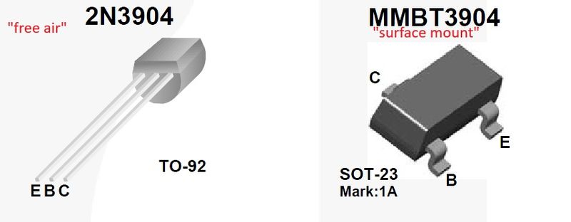

That is what I'm sure you and I have. There are three cables that plug into the rear of that module each having their own part number. One is clearly for front USB3 ports. The other big one is where most of the I/O wires go. The smaller other one is likely for front mic/headphones. I can't find a shrink-wrap-hidden thermistor, but maybe you can. There is another possibility... instead of a "free-air" version HP may have switched to a "surface-mount" version. That might be inside the I/O module noted above, or even on the motherboard. Take a look at this old post for more on the 2N3904 HP used in earlier workstations: HERE
These two are supposedly near equivalent except for form factor and attachment:
HP used the free air version earlier including in the ZX20 family

You might want to get a different front I/O module and see if that helps. Those modules are the same for the Z440 and the Z640 and maybe the Z840. Another possibility is that this part of the motherboard's control system has gone bad. I had a Z440 lose function of its top front charging USB port and tried an I/O module replacement (which did not work because it was a motherboard issue). Had to do a MB transplant to fix that. But that is different engineering, and it does not mean there is no failed/failing surface mount mmbt3904 inside the I/O module. HP has used some of the same wiring/colors over different workstation generations. Maybe go try to find a brown/gray pair on the cable's motherboard end... look at the plug with the most wires.
