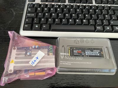

3.  Insert your ZTD G2 into PCIe slot #4. That is an x8 form factor slot, but the card will only use the first x4 lanes. The 950 Pro inside the card will be in a RAW condition, GPT partitioned, blank. I found if I used a NTFS formatted drive at this stage it added some unnecessary low level stuff. You want to present the W11 24H2 installer a RAW drive to work with. Power cord is removed, of course, whenever working inside the case.

Getting the retaining screw for the M.2 is difficult without mangling the Wrigley’s Spearmint chewing gum!

Once you get ahold of it put it on the M.2 before you plug the stick into the M.2's socket. The M.2 stick becomes a hold-down screw holder!

Yes indeed.  It was just fiddly trying to remove screw down holder to then put it on the M.2.

I double checked and just finished a Samsung 950 Pro 512GB W11 24H2 using the steps above. I found some added info to include. The process works as well on the Samsung M.2 drive as on the specified Intel Add-In Card hardware. This is not a bad project once you've done it once.
