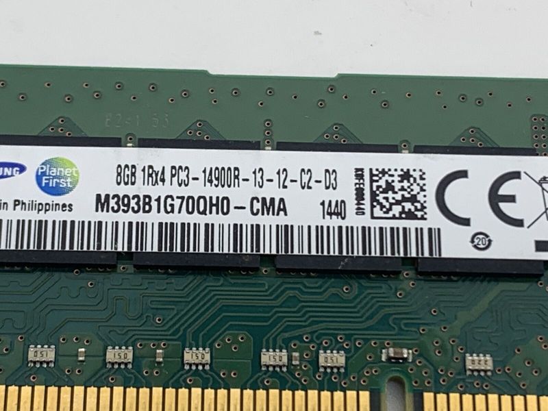

I have not worked with the Z800 but my extensive work with the version 2 Z600 and the version 2 ZX20 workstations might help you.  It is important to know if you have a v1 or a v2 Z800... it is for the Z600.  The V2 motherboards got a new memory controller, and this works with the v2:
I found retired 14900R memory we have been using in our Z620/Z420 v2 workstations also worked perfectly in our Z600 v2 workstations.  I got quite a few of those in the $12.00-15.00 USD range, 8GB size, and chose to only buy the Samsung versions because that was what was available at the time in good quantities.  It is all a supply/demand thing for cost, and if you buy more you can haggle more.  These mostly came from IBM and Dell servers, but also from some HP servers.  I always prefer HP memory, but these all had the same codes.  You can see what parts of the codes are important to match.... the ones at the end no so much., from Samsung memory spec PDFs.
Here is a pic:
M393B1G70QH0-CMA
