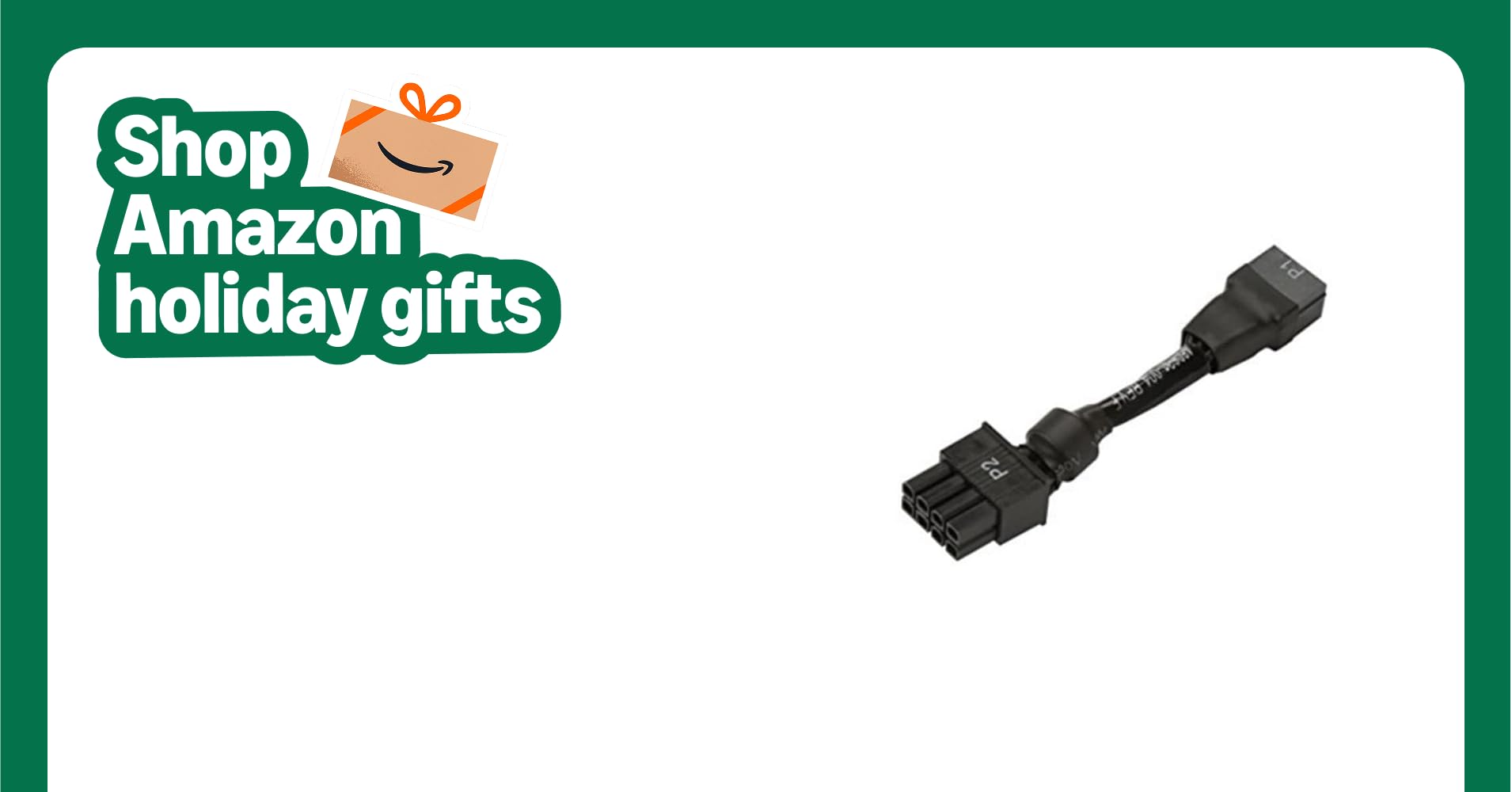

the z820 1125W power supply CAN run three 8 (or 4) pin GPU connectors off of the three 6 pin GPU connectors using six to 8 pin adapters as long as you don't exceed the power supplies TOTAL AVAILABLE OUTPUT ON THE GPU RAIL
https://www.amazon.com/HP-Power-Supply-Adapter-N1G35AA/dp/B011Z74OGW

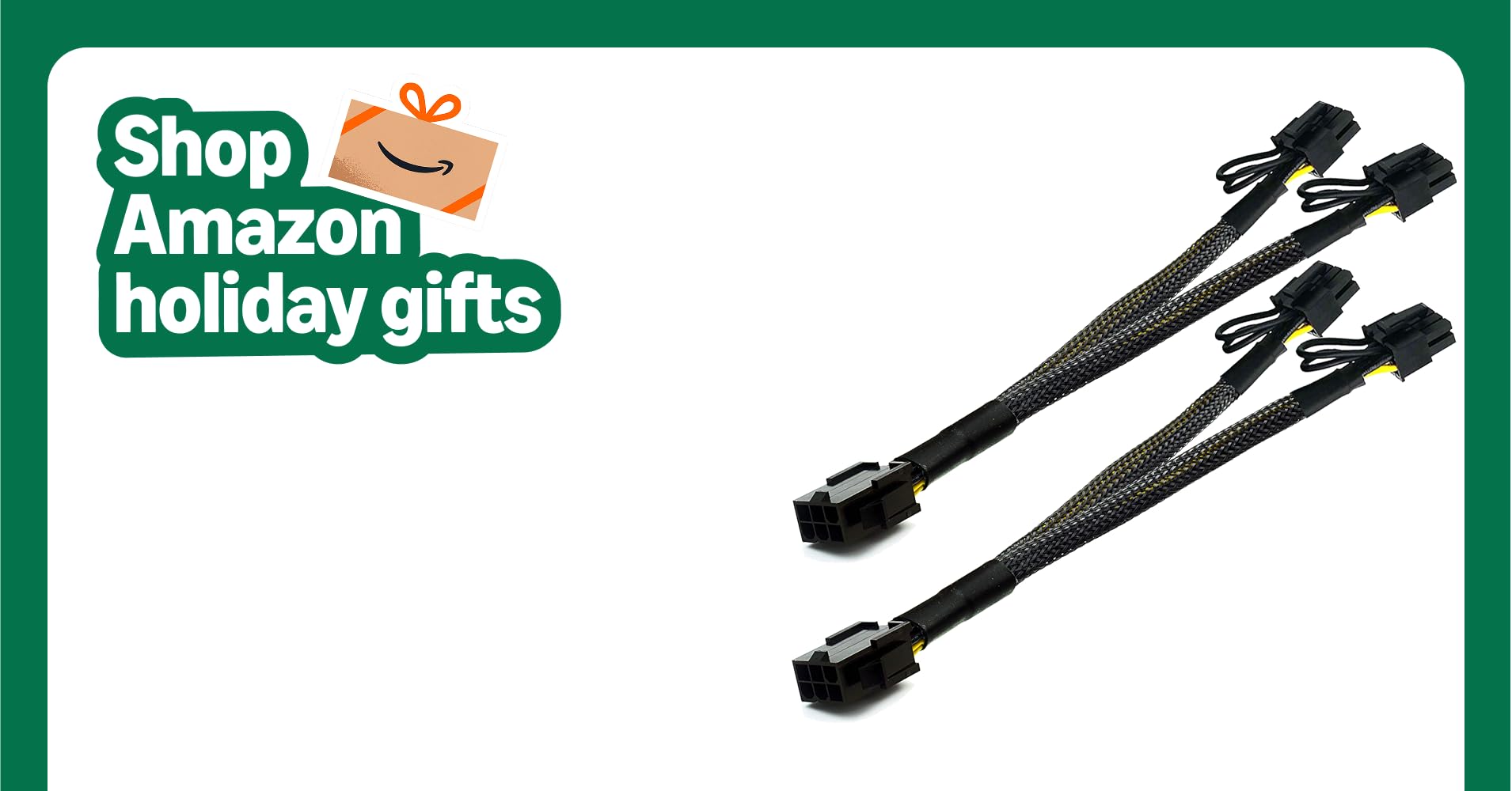

last, how do you get four 8 pin connectors from three 6 pin? simple you use a six pin to dual 8 pin adapter
https://www.amazon.com/Graphics-Express-Y-Splitter-Extension-TeamProfitcom/dp/B07C35YR6V
