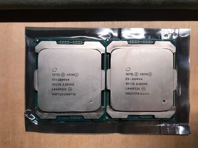

i cannot stress this enough,..... you must use RETAIL cpu's
eval units will not work or will not work reliably
your 2699 cpu's must be "SR2JS" any other code indicates it is a non retail ES/QL cpu
They are both SR2JS:
since your system boots with the v3 cpu but not the v4 2699(s) a last test is to buy one (or two) v4 cpu's from a reseller that is willing to take returns.
if you go this route please make clear to the seller before buying that your existing v4 cpu's will not work  but that a v3 cpu does and that if the v4 cpu's from him fail, it's not the cpu's but your system that is at fault and the returned cpu's are most likely fine and offer to pay for the return dhipping even if the seller said he will cover return shipping

as unlikely as it sounds i suspect the original 2699 cpu's to be the cause of the no boot issue which is why i recomended a replacement test v4 cpu
no, the HP power supply is not at fault here your no boot issue with the original 2599 cpu's is not power supply related

Both of my 2699 chips were form the same seller. So I do wonder if that could be the problem.
I will see how the one I ordered goes and if that works, then it might be worth getting another 269X series form a different seller.
The 2640v4 arrived, and..... it booted!
So it sounds like your theory of multiple bad 2699s is the more likely version at this point. I will see if I can source another 2699 or similar from a different seller to confirm.
