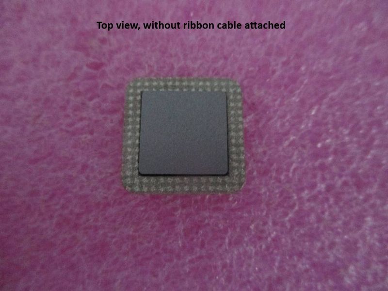

You can find the missing module if you did not get this option. It also could be there but defective. The info below and Google can get you going. See the bottom video link first, from HP, and go into it to 14:45 to start with. You'll need to be handy if you choose to add in a module and I'd check first to make sure you have the necessary ribbon cable and silver metal baseplate hopefully in place even if you don't have the sensor module yet.
HP ZBook Power G7 fingerprint sensor (AKA "fingerprint reader").
HP part number = M07151-001 (Search for that via google to see cost and sources, and also check HP PartSurfer because recent new parts may be even less expensive directly from HP)
Edit: A couple of pictures and you'll also see the parts in the HP parts video:
https://youtu.be/gpMjVp0bHqU
(a video from HP on how to set the capability up in your OS)
https://youtu.be/jCxeGURxaUw
(a video from HP on how to install/replace the sensor/reader module; see 14:45-16:10 in the video)
