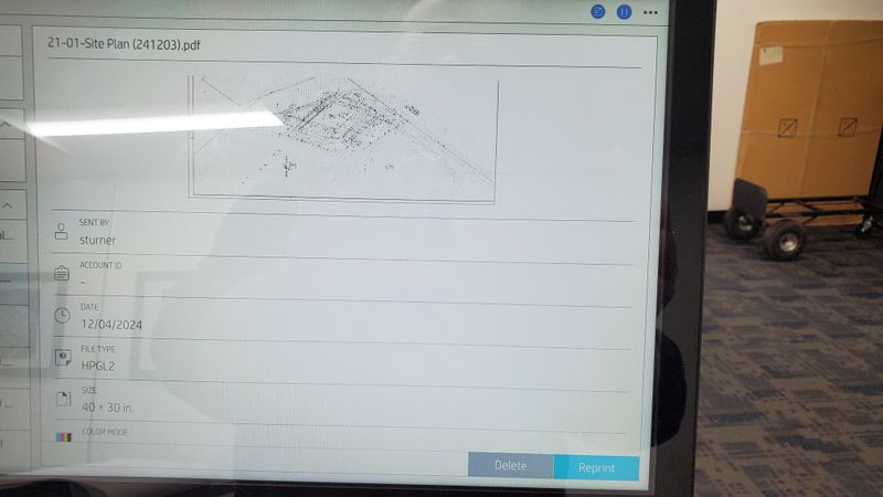

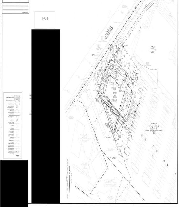

The following images are to show how a 30x42 PDF is sent to the plotter. The plotter changes the size to 30x40 as you can see in the picture of the plotter screen. The final image shows the printed output, stretched and cut off. Riddle me that.
Print dialogPrint dialogHP screenHP screenoutputoutput
We have given up on the HPGL/2 drivers as they are junk. The PCL3 driver appears to be managing sheet size and scaling correctly. At least with the testing in Windows.
