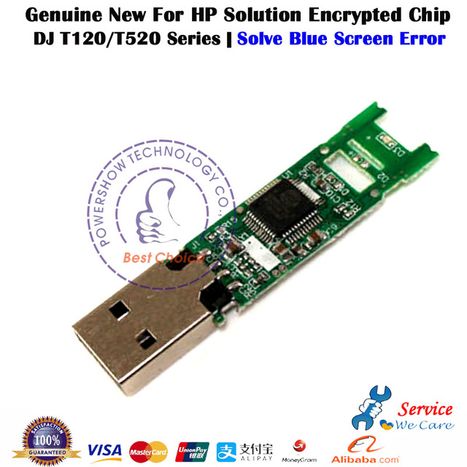

I used this part from Ebay and it worked
it is called encrypted chip
https://www.ebay.com/itm/282991877071
Original-New-Solve-Blue-Screen-Error-Solution-Encrypted-chip-CQ890-67097-CQ891-67097-For-HP-Designjet.jpg_640x640.jpg
