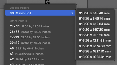

For anyone following along or reading this in the future, I've made *some* progress today. I noticed that in page size, there's a category for loaded roll:
Which allowed me to print in the correct orientation. However, I'd rather not have to convert to MM each time and would instead like to be able to choose the appropriate ARCH paper.
