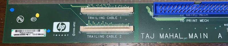

OK, I went ahead and pulled the main board. I'm no expert but I took a pretty close look at it with my loupe and didn't see anything obvious. No bulging capacitors, no cold solder joints, nothing burned and no cracks. All of the connectors seem fine.
Anything special I should look for as a sign of a failing main board?
Main A board topMain A board topMain A board bottomMain A board bottomMain A board  labelsMain A board labels

UPDATE:
I put the Main PCA and assembly back together and tried it once again (maybe the disassembly/assembly fixed it???) but no luck. It still has the same error and same behavior.
Unless anyone has another suggestions I'll look for a used formatter board. Looks like I can get them for under $100 used (bare board, no HDD). Hope this fixes it!
