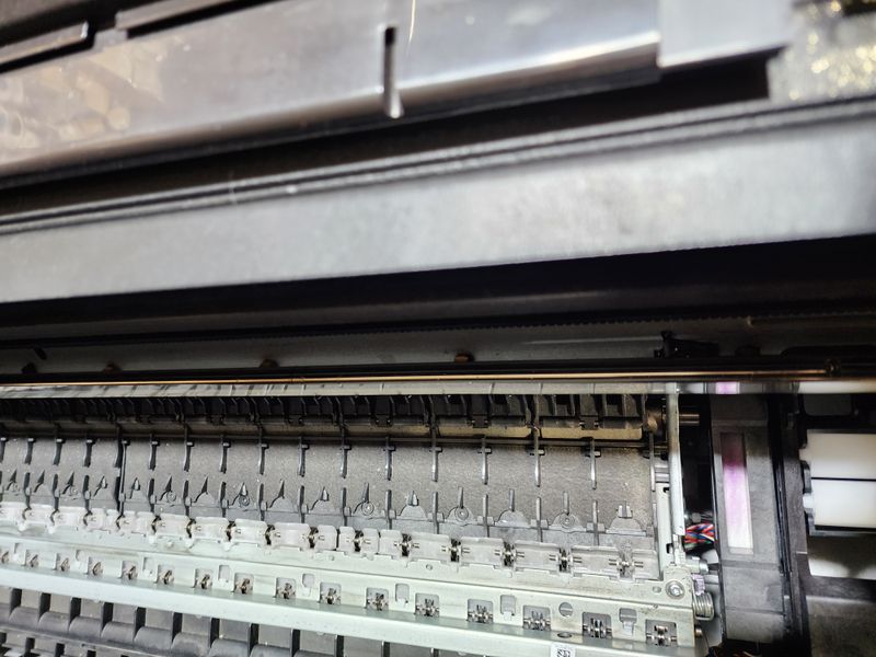

HP T3500 desinjet continues printing without paper. It just sits printing and dumping ink in the paper path.  You can;t really see it in the photo but it is in the part right before the paper star wheel assebly.  20241218_100254.jpg

Symptoms would suggest that the Top Of Form sensor is defective. You would be best served by finding a service manual for the product and using the diagnostics to test all the sensors.

The line sensor is what you are referring to correct? Or am i unaware of another sensor that detects the page position?  Thank you.
The oops sensor is in the paper path near the right edge. Get a good flashlight and look at the slot where the paper enters.
https://www.lpscomputer.com/products/out-of-paper-sensor-oops-for-t-z-printers-q5669-67068-q5669-678...
