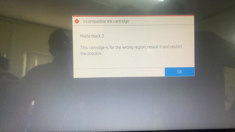

My printer is in UAE. We have been using HP730 (P2V65A) ink cartridges.
But the latest cartridge that i bought is HP 730b (3ED45A). I was told that this is the replacement for HP 730.
But the printer is showing the following error (Attached screenshot for your reference):
"Incompatible ink cartridge.
The cartridge is for the wrong region, reseat it and restart the process."
Kindly advise.
You need to use a P2V65A ink cartridge.
The 3ED45A is not for your region, it's for India.
