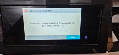

I was not able to get through this step.  I made sure the firmware was up to date and sen the print job.  It went through about 15 to 20 pages and got a print system failure error.
