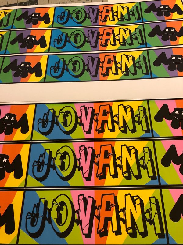

All of my ink cartridges and ink heads are showing fine in system maintenance. I'm getting a check after all of my alignment print outs as well.
However, when I print something rather large (see attached) one of my ink heads go out. It was purple then turned pink
Can anyone take a guess as to which one I should replace?
I have already replaced two (can't remember the colors).

Your green is also going from darker to lighter, it could be due to C or LC printhead.
Use excel to paint 6 columns in 6 colours and print a few pages that will confirm what colour is fading.

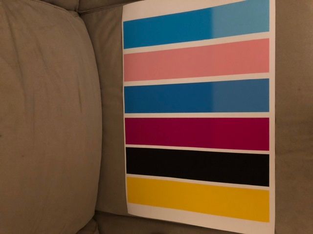

That was genius to do the printout in excel. Thank you
Is it possible that light cyan could be the one ? See attached.
I’m thinking in the last two weeks I changed ink heads magenta, light magenta and dark cyan.
