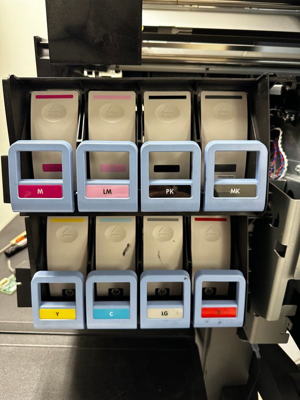

What do i need to do to fix this?
i have tried 4 cartridges and all the same i have changed the sensor and the upper board and still no change what should i proceed with next?

So couple things id like to address.
firstly we began using all real ink expired as indicated on machine.

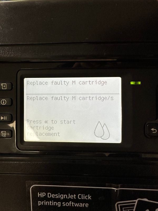

It ran smooth till it needed a cartridge change we changed it no problems. Then randomly as we bought a test batch of a new cartridge set, we were testing them and the magenta suddenly stopped being detected. I requested a technician which costs a lot to bring and he let us know that it could be the whole tube assembly and that if you change the upper board it could work since it seems to have been static shocked. Afterwards we changed the sensor and changed the upper ink system board. It worked and now beeps when the ink is inserted. Unfortunately we have a new problem where the ink always shows as faulty ink cartridge and to replace.

Can you post a picture of the error message that pops up?

1. the magenta tray
2. the sensor of the magenta tray
3. the version is - PTR8_03_07_06.1
4. I did and it does show the same error
5.
