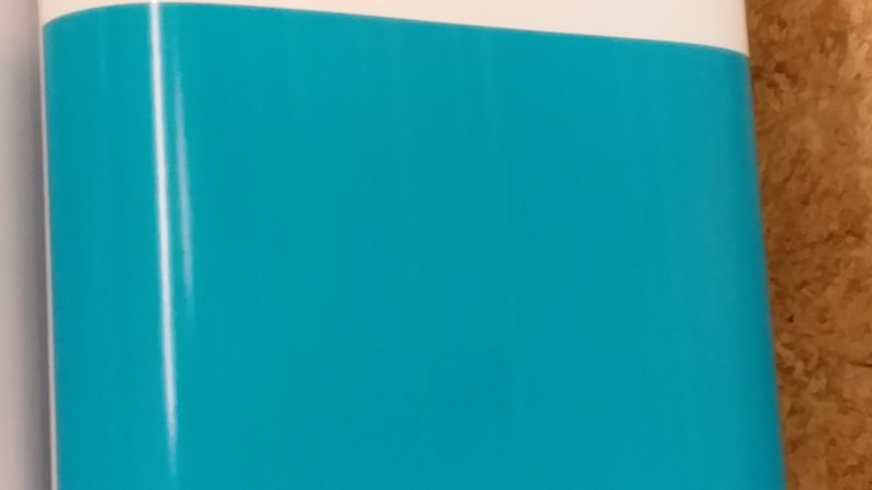

Recent solution for this banding - replace PH, shake ink cartridges (in our case ink boxes) after some time if not printing, master restart of printer for 5 minutes (from switch on the back) once a week at least.after one year of workafter one year of workIMG_20190315_143026.jpgstrange result before PH replacementstrange result before PH replacement

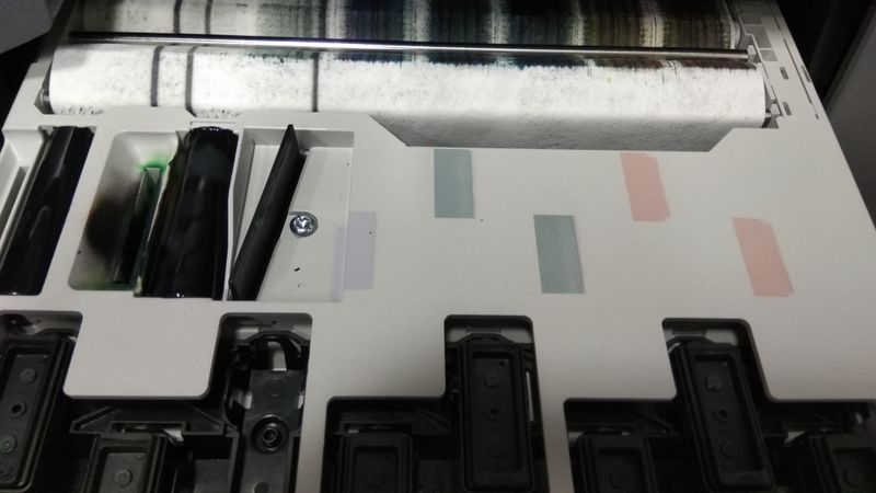

Cossack81 right now a tech minion is at the maintenance cartridge case (all row of printheads are hitting and has to be replaced at once) with our 570, but my thumbs up for moving from hp latex...only problems... when done (if case is solved) - will tell 🙂
