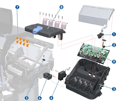

sure, please see the line sensor located as the picture below.
the line sensor located at point number 3.
line sensor tightened by 1 screw to carriage assy . before unscrew it, make sure to unplug the power source and open the right cover then remove the flexible cable connection from PCA board. Be careful for doing this, the component very small and vulnerable damaged.
