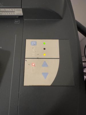

2. Physically inspected the scanner, including the FireWire interface board, which appears to be in good condition.
3. Updated the drivers to the latest available version.
4. Replaced the BIOS battery in the original HP computer.
5. Consulted the service manual for the equipment and reviewed all error sequences that could appear on the front panel. No errors are displayed, indicating the scanner is technically operational.
