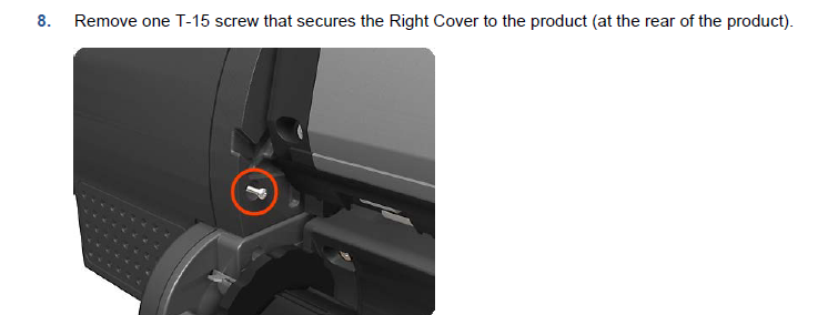

I am struggling to remove the right cover. There is a screw or something holding at the back and I have searched everywhere to figure it out. All other screws are out but I can tell there is one more hidden. The manual is not helping and I can’t find a video showing this removal. I am afraid of breaking if I keep pulling on it.
You have to remove the media diverter to get to a hidden screw...

If you followed all the manual steps there should not be any screws left.
It is very easy to remove the wrong screw from the roll cavity area.

Pg476 step 8, sure. But that is a **bleep**ty picture and not a picture of a T2300. The T2300 has two paper rolls and I have removed every visible screw that might be the one holding on to the cover. Still something holding on to the cover. Someone who has actually taken one apart will know where the hidden one is or what I need to do. The service manual is not getting it done.
 the screw should be right here. The cover is holding on at this spot as if there was a screw underneath that piece with a 2 on it. Yes, I have removed the screw on the end of that piece, and every other screw in the area. The cover is still held in place. I am stopped in my troubleshooting and there is black ink dripping all over from underneath this cover.
Pg 345, the Converger. Thank you for solving the problem.
