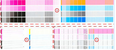

Machine stopped printing blue [started out blue, then peters out to light blue] Replaced blue cartridge - no difference. replaced blue/green printhead - no help.
Suggested solutions appreciated.
4 REPLIES 4
Hello,
Do you have the result of the  Printhead Alignment ? can you share it
its look like below example :
all plots are available under service utilities then “Diagnostic Print
Visual Alignment Diagnostic
also, the nuzzle health from print diagnostic :

You should change lC, LM and photo black, LG print head, ensure that cartridge is ok. Check ink tube maybe It  have some air inside. The tubes should have ink full. Sorry my english.

Ok. Try download service manual. Entry service menu by front panel and run carriage assembly test. If the test fails then it will show an error.
