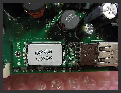

chip na plytce.jpgHello
You need to replace HP Encrypted chip
It is inside the printer on main PCA
in USB slot
Like this one
