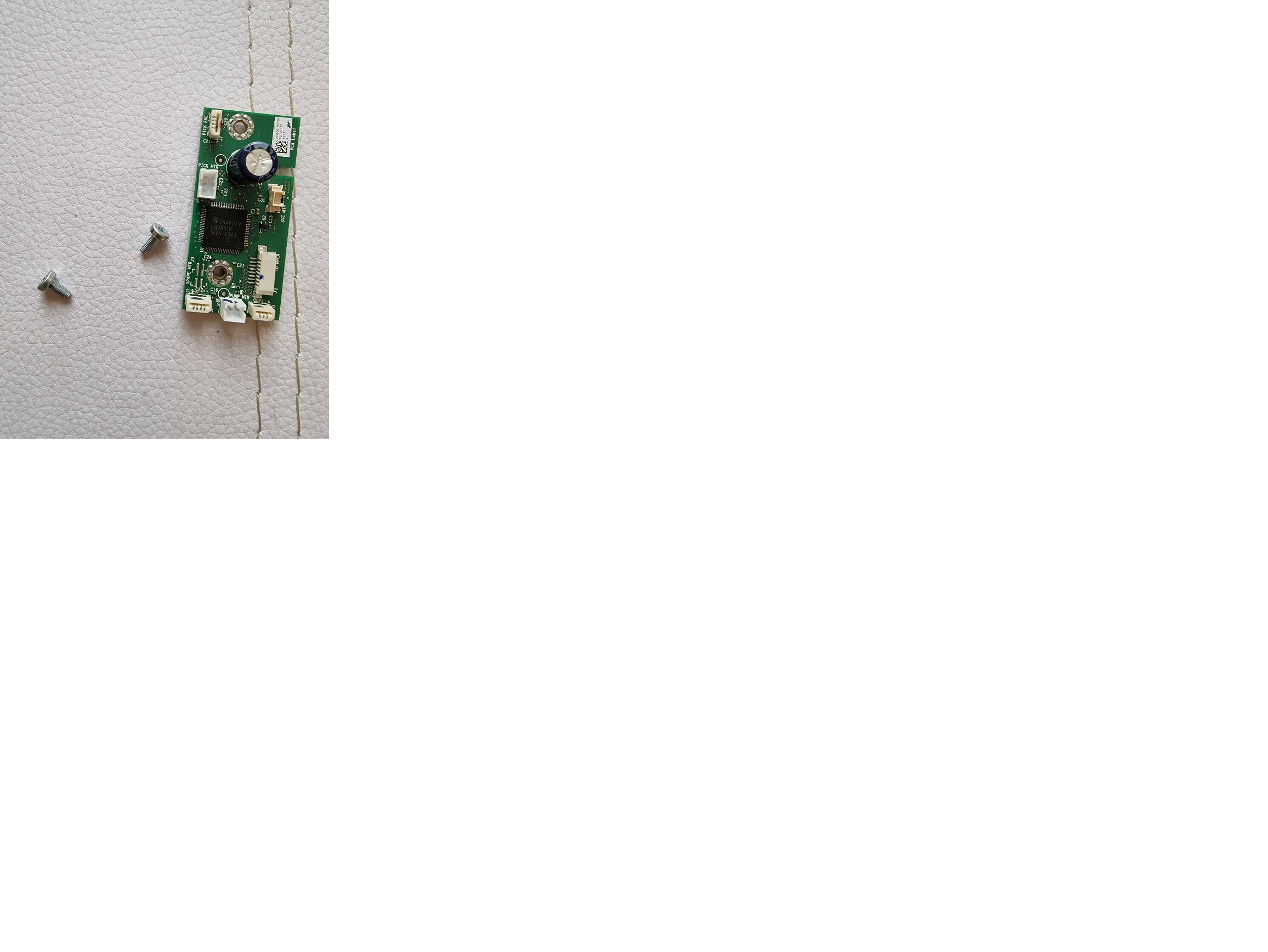

04-26-2022 06:31 PM - edited 04-26-2022 07:04 PM
The attached pca, correct? (Well, don't know if that pic upload is going to work--PN
CQ890-67022
, correct?) Thanks for your input. I'll check it out, and try to post back. I bet you are right. Although totally different printer and just now thinking about it, after printhead replacement, I had a continual "reseat" on a black/yellow printhead on an L26500 and the solution was carriage pca replacement. I bet similar principle.
