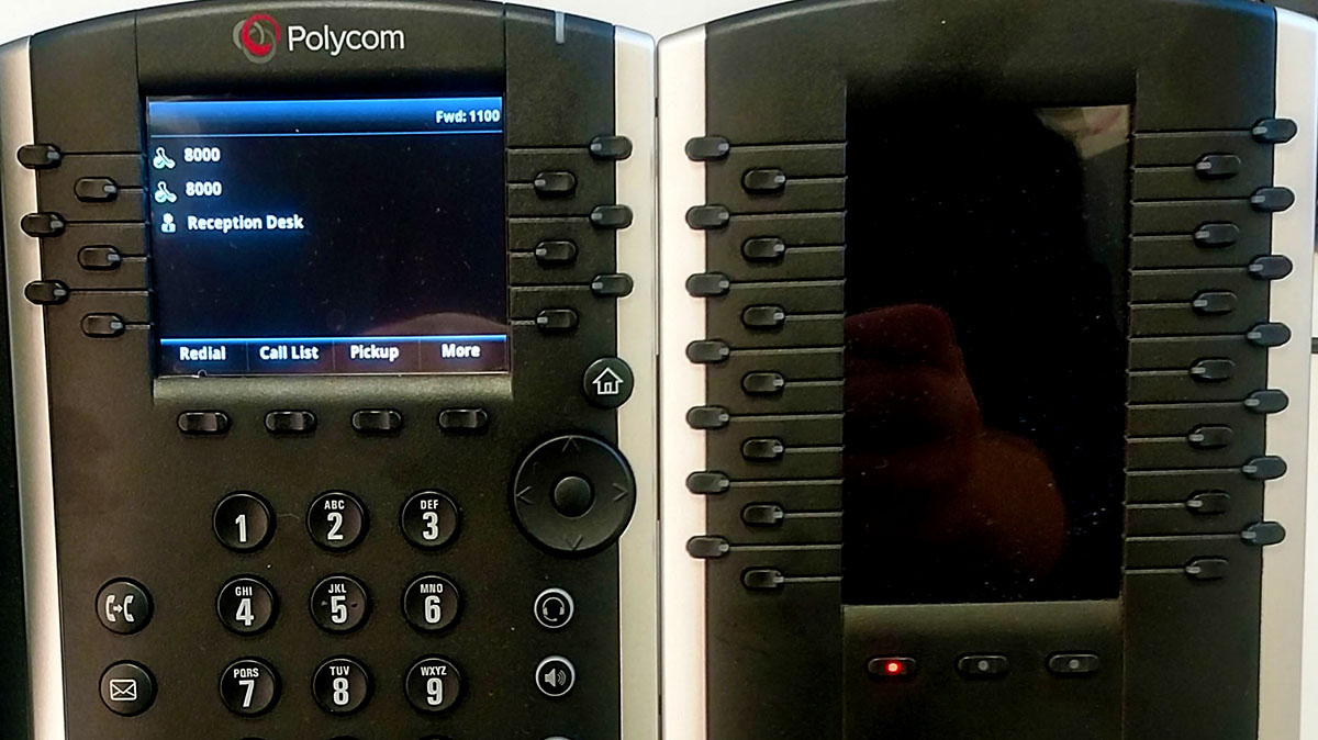

I've decided to share my experience with getting the Busy Lamp Field (BFL) list to show on a VVX410 / VVX411 handsets and the expansion module since I can't find this issue documented anywhere and it is extremely difficult to debug. Hopefully it will save someone some time.
This might affect more Polycom models in VVX400 series
Problem:
I've had a BFL list of 40+ configured on the server but these would never show on the device.
Most often it will only show one single BFL after that line was manually dialed.
This was extremely frustrating as it was rendering the expansion module useless and the service provider would refuse to offer support blaming this on a network configuration.

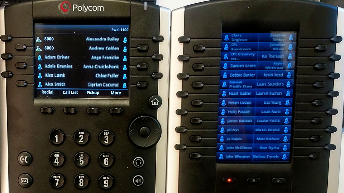

By chance I discovered that the handset will consistently display all BFLs correctly only if connected to a specific wall socket in the building. No other wall socket would work.
Furthermore, it will not work if directly conencted to the exact same port on the network switch.
It turned out two wires came loose and became disconnected at the back of the wall socket (pin 4 and 5 – blue and blue/white wires in the left side port in the attached picture) and this was triggering something on the handset to correctly display the BFL list on the main unit and expansion module.
Solution:
After further testing it seems it is sufficient to disconnect only one of the two wires, either pin 4 or 5, and restart the handset. BFL will then work ok and no other functions of the phone are affected.
Weirdly, if I would disconnect the two wires while the phone is on, it would do a short ring/sound alert and briefly display "Network is down" in the status bar, though everything would work fine including in/out calls. BFL list will become populated after a restart.
Reconnecting the wires while the phone was on did not break the BFL list and it could still be used and live updated via the portal. It will however break again after a restart.
