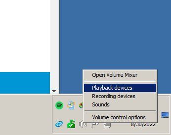

  1. right-click the speaker in the TaskBar
  2. select "Playback devices" menu item
  3. and it shows "Dell U2415" (as well as the internal speakers and the external USB microStreamer signal processor)
