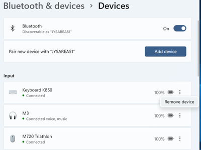

A lot of Bluetooth devices simply lose connectivity and the laptops cannot reacquire the device..  For example, if I lost connectivity with my M3 device I would have the laptop "remove it" and then search for it using "add device"
A button on the device would have to be pressed to tell the M3 to expose itself.
Another problem is a 3rd party or Microsoft update that replaces a working HP Bluetooth driver with one that does not work.
try installing this driver and see if it fixes the problem
https://ftp.hp.com/pub/softpaq/sp135501-136000/sp135768.exe
Also, make sure that Bluetooth is actually turned on as shown in the image above
