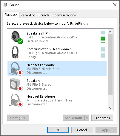

Looking at my device manager again I can see that the Driver is still not showing up. If all else fails I will look into reverting back to Windows 8 and accept that as a possible solution!
Also I have uninstalled those portable speaker devices and removed them from the list but they keep showing back up while they are not connected!
You're very welcome.
I don't see any bluetooth devices showing up in your screenshot, so they aren't BT speakers.
It is probably your Samsung phone adding those.
I think you should disconnect your phone from the PC and see what happens.

No it is not the phone, I only connected the phone for charging and denied MTP connection. Also this has been happening continually without the phone plugged in.
