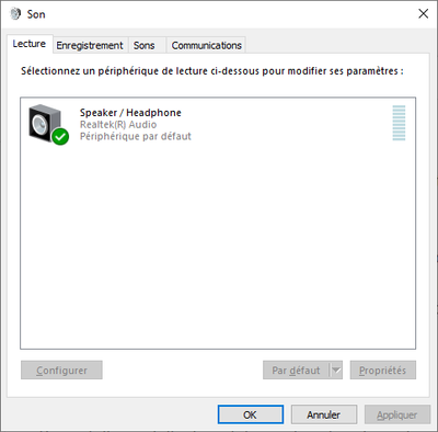

Now here is a screenshot before inserting the headphones into the jack:
After inserting the headphones into the jack:
In the device manager in "éntrées et sorties audio" there is microphone headset which appears once the headphones are connected. In the sound manager there is a microphone headset which appears once the headphones are connected.
