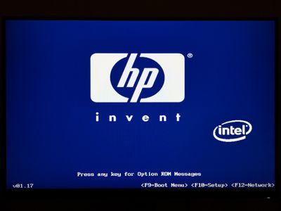

I've recently started experiencing this problem on bootup. My desktop used to bootup normally but more recently has started booting up to the blue HP screen (see below):
So I press the spacebar and end up on the following screen. I can boot up by pressing F1 from here but the pc is struggling with some more intensive tasks (specifically photo editing software) that it used to handle with relative ease. Can anyone advise a solution, be it ram replacement or repair or if it is a symptom of a different problem. I've tried reseating both of the two RAM modules but it hasn't made any difference.

normally the message tells you the problem with dimm2, so try without this module to start
if this is no longer a problem, it must be changed
