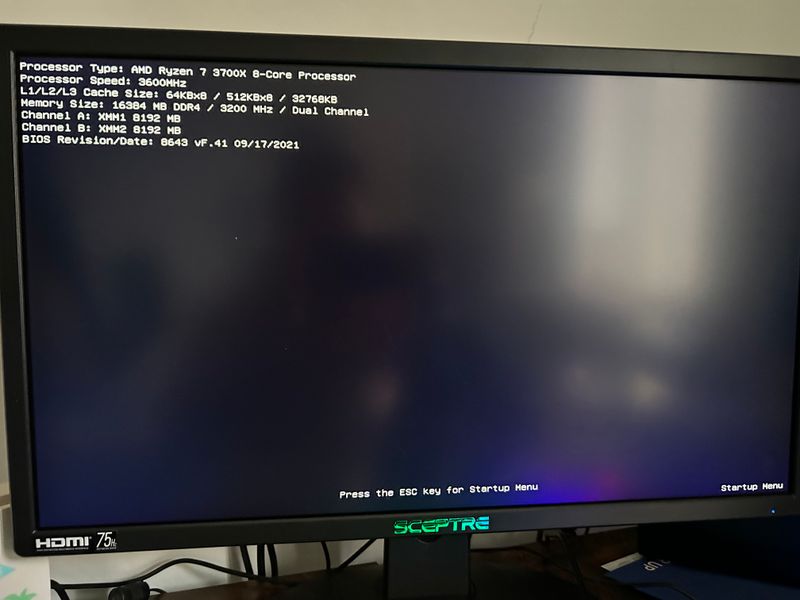

i am trying to figure out what is wrong with my computer when i tries to boot up. I have changed the CMOS battery and have tried multiple different ways to restart and used different keyboards one being wired and one wireless and I am starting to get really frustrated  IMG_0425.jpeg

Your PC can Power On Self Test. That's a good sign. Your PC's screen image included with your Forum post suggests the BIOS should be okay.
I'm thinking the PC might have a system drive problem.
