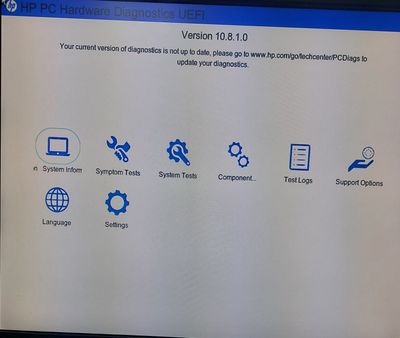

UEFI diagnostics show the two hard drives exist and both test ok, but it did show a software memory fault on the quick test but still passed the extended memory tests.

The UEFI does state it wants updating.
Currently 10.8.1.0
