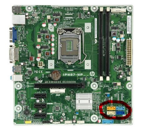

If the connectors are fully plugged in and not damaged I suggest you try a different SATA connector on the motherboard. Your board has four SATA connectors. Here's a photo of your motherboard with the connectors highlighted.

Today I have read your message, I open the computer, and  I see that the connector of the Hard Drive are ok (how do I know if them are wrong?) then I see the 4 SATA connector on the motherboard as your picture (thanks) and I unplug the SATA 0 and I plug into the other free SATA Connector called "SATA 1". I also unplug the SATA2 and plug again there (it is the CD/DVD right?)
I also clean the computer dust.
I open the computer and still appearing the error.
