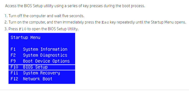

Can you run Windows? The following HP Startup Menu screen should appear when you tap "ESC" at startup:
You should be able to select "F10" at this screen to enter the BIOS. You can also select "F2" to run diagnostics.
You may have a hardware problem if you don't see the above screen. You would have to test all hardware components possibly using replacement parts to find the cause. Try a simple and cheap fix by replacing the CR2032 motherboard battery.
It is tough to guess your issue using the information you are providing. You have video and USB function but the PC is not working correctly.
