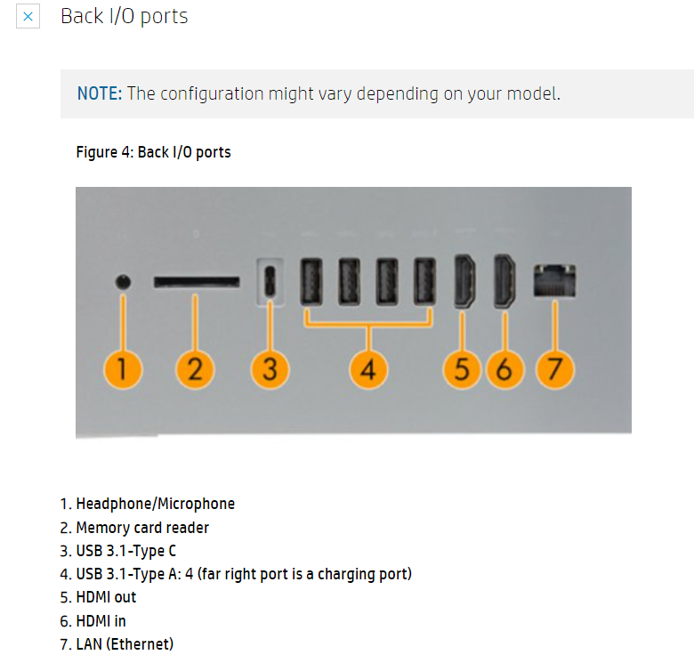

The rear I/O is as follows:
Can you trace the rear HDMI input and output to the component that appears to be a M.2 drive on the motherboard?
Regards

This is the motherboard (MB) in your AIO:
The HDMI I/O is integrated in the MB. The M.2 socket is not the graphics card, it is a M.2 SSD.
It looks like the graphics may be integrated in the MB. It may be best to have a local PC technician take a look.

The M2 next to the HDD is the SSD I added myself. Cannot find any piece. While the piece next to the CPU fan is Wifi. I will try find the graphic chip again by tracking from the HDMI.
