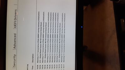

I have a HP Z4 G4 Core-X hat wont boo past the "Protected by HP Secure Boot Screen". I updated the BIOS to 02.74 Rev.A to try address an issue whereby when I restarted via Windows it would freeze on the same HP secure boot screen (press and hold power and short press power would allow machine to boot to OS)
I've done various things to get it to boot such as
1 Reverted BIOs to default settings
2 Run Diagnostics - all clear
3 Booted the machine with no peripherals attached
There is a warning in the BIOs logs regarding DIMM, see below.
Next step is I'll remove some memory and try get it to boot to OS.
FYI BIOs seem fine via F10 (I.e. not corrupted)

Hi All,
FYI I've fixed this.
Took a look inside and someone had decided to fit a RAM stick in DIMM7 that was not the same model/type of the others.
Machine boots to OS fine now.
Thanks

Hi All,
Thanks
