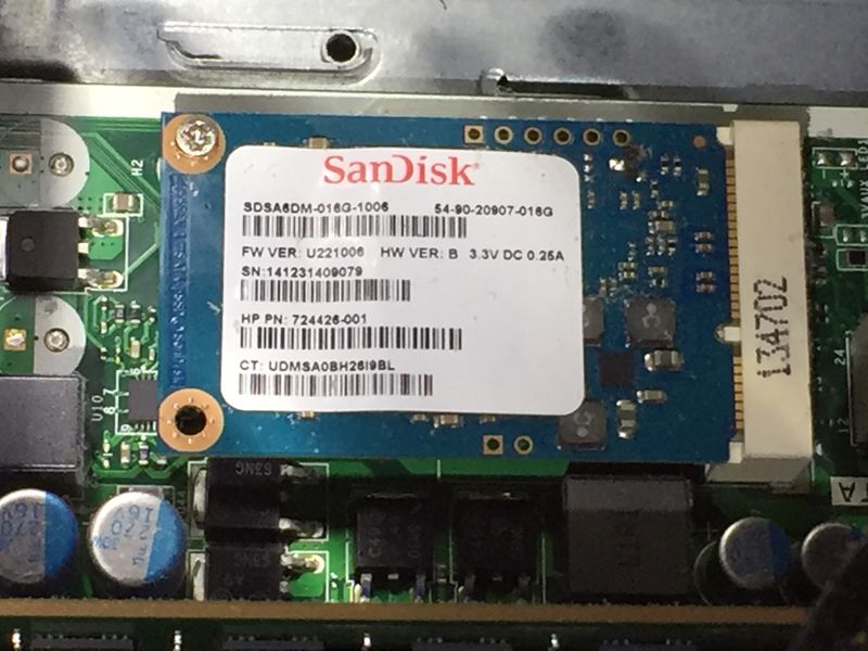

You don't see anything like this on the motherboard?
This is a picture of one of the Sandisk SSD actual part numbers listed in the parts list I posted (680966-001).
The other Sandisk mocel (724426-001) looks very much the same, except that it is blue.
Actually, I had not looked inside the box. When I did, I found this.
So this is the culprit. It seems easy to get to. I'll look for an equivalent card since the exact part number didn't seen to be readily available on the Internet. I didn't try at the HP site, though.

Yep that's the one.
There are plenty of them on eBay.
Just search by the second part number I mentioned.  That's the blue one.
