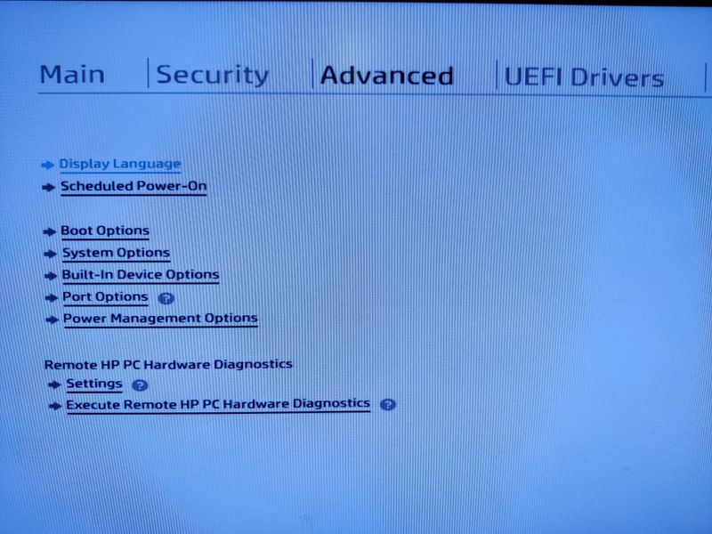

It's perfect for work/study - incredible processor especially combined with nVme , but the problem I see is when you load the CPU the temperature rise to 90C and more. And the Cooling Fan didn't rise the working speed. The only thing I find to prevent this overheating is to increase the minimum fan speed (the idle fan speed). When you make it 70-80% the temperature drops to around 70C at heavy load and near 40C with normal Work. But I don't think working always at 80% is OK for the Fan and it's kind of noisy especially when you don't need it.
So is there a way to control this CPU Fan from Windows (I try maybe every program for fan control and this fan is not visible), or to make the Fan Control automatic depending on temperature? This is the only problem that I see in this HP ProDesk sistem.
This is how BIOS looksThis is how BIOS looksThis is only way to control this fan.This is only way to control this fan.

The basic answer to your question is NO -- and since you have tried third-party fan controls apps and they do not work, then there is nothing more you can do from with Windows.

And even I was sure it will not work I try everything that you suggest, I even put the miniPC Opened (without cover), at the tripod in the middle of the desk - yes it drops few degrees, but still, if you put it on heavy load temp is rising over 80-90C, and you still need CoolerFan to run at 70-80% to keep it below 80C. Maybe I had to start that My hobby for more than 20 years is to assemble and support Desktop machines for me, my friends and my office. So I have some experience and knowledge with airflows and CPUs without or with a heavy load. When some processor is under heavy load there is no Airflow or positioning of the box that can cool it down - only a good cooler (mostly with a fan), can do the job. And here HP put 6 Cores 12 Threads CPU with Clockspeed: from 3.3 to 4.2GHz almost with no cooling. And in CPU marks it has results almost like Intel Core i7-9700K - So you have perfect CPU with TDP  of 35W  and you can't use it\s power?!?
So the Conclusion is:  you are buying from HP a sports car and you can drive it only in first gear.  If you want to use other gears you must go through service every time. Most peoples that will buy this miniPC didn't know what is BIOS. They expect to buy something with a powerful CPU and to use it.
I saw that on the motherboard there is 1 more Fan connector slot, I try it but it is still not discoverable under windows at least it's working. So Maybe I will try to put 1 more Fan inside and to make 2 Fans at a lower %speed.
I really hope that someday HP will come with an update of the motherboard or something else that will make this CoolerFan visible, or at least Add an option in BIOS to have temperature control - Like if the temperature is under 70C - 20%, when it passes 70C - 80% - is this really so hard? THis machine cost like 600-700Euros.
