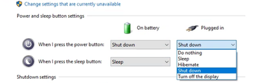

If the click you hear comes from the power supply then probably a physical problem with the power supply.
If the noise comes from the hard drive that indicates a shutdown problem possibly software (driver) related and not the power supply.,
Look in the event viewer under both system and applications for errors such as "xxx vetoed the shudown"  or timeouts where something is phoning home and cannot make a confection.
In the meantime replace the power switch setting:  type "powercfg.cpl" in the windows search and change shutdown to hibernate.

       I could not determine where the click was coming from, so I changed what the power switch does, it wakes the PC up from the sleep mode.
Thank you so much for the help.
