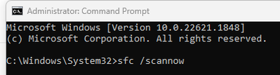

The code to be run in command prompt given in solution, doesn't work in my case. It says this type of file does not exist or any such similar response,
What code is it?  What is the name of the file that does not exist?

if you can get into windows, either normal or safe mode then try file repair using administrator prompt

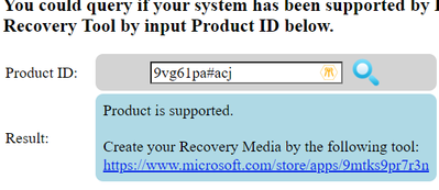

If the above does now not work you can boot a recovery USB and try doing a repair.  Your system has a cloud recovery tool and instructions are here
If you decide to run the recovery tool and do an install, then be sure to specify that documents be preserved.  Try doing the startup repair first and a full install only if you have backup of important documents.
