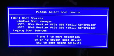

I recently had access to the same model HP computer as the one that is not working. They were purchased at the same time. However, the BIOS is still at the original version on the working system. Here are some images of what should be displayed when pressing the ESC, F9 and F10 keys.
ESCESCF9F9F10F10
When compared with the original images from the computer with the updated BIOS it's evident that the BIOS is failing to completely load the user interface when pressing an action key at power on.
