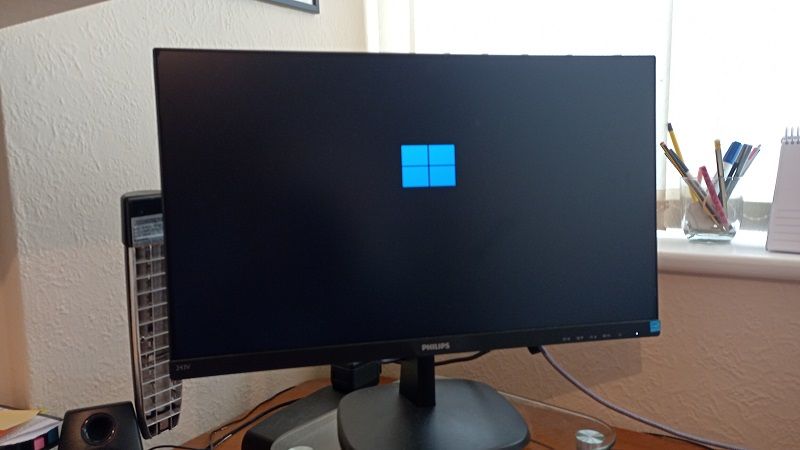

My customer had a problem with a new HP Slim S01-pF2011na Desktop PC with Windows 11. Within the first 30 days of use, it got stuck at bootup with a black screen with a blue Windows 11 logo and no progress. The circling white dot that should be in the middle of the screen did not appear.
The customer turned the PC off by pulling the power plug. The customer plugged it back in again and it said, "Preparing automatic repair" for hours with no progress.

Other times it would just give the same Windows 11 blue logo and no white dot. Sometimes it would say "Preparing Automatic Repair" again with no progress. Sometimes it asked for the Bitlocker Key which I found in the customer's Microsoft Account under Devices.
After trying for some time we noticed that if the HP logo appeared at startup, then it was going to work. If the blue Windows 11 logo appeared at startup, it was not going to work.

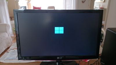

Within an hour of using the replacement computer, the same problem happened again!
Another PC, same make and model, same problemAnother PC, same make and model, same problem
I spent more time turning it on, pressing Escape at boot and it sometimes then loading normally, being asked at random for the Bitlocker key, or it saying "Preparing Automatic Repair"...

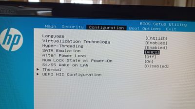

So I tried putting in a new M.2 SSD. Starting the PC with a Windows installation media USB flash drive, I found Windows Setup said, "We couldn't find any drives". Rather than trying to load a driver, I wondered if there was something in the BIOS that could be changed. I read online elsewhere, if a PC is in AHCI mode then a storage driver isn't needed.
To try it, I went into the BIOS, chose Configuration and then changed SATA Mode from RAID to AHCI.
Change RAID to AHCIChange RAID to AHCI
I tried the Windows installation USB flash drive again and this time the unpartitioned M.2 SSD was found by Windows Setup.

What you’ve described is actually spot-on: the RAID controller mode in BIOS can cause instability on entry-level desktops like the HP Slim S01 series when paired with Windows 11. By default, HP ships many models with SATA Emulation set to RAID (even when there’s only a single drive). This can create boot issues if the Intel Rapid Storage Technology (IRST) driver fails to initialize properly, which explains why the PC would hang on the blue Windows logo or loop into Preparing Automatic Repair.
Your fix switching SATA Emulation from RAID → AHCI and then performing System Recovery ensures Windows uses the native AHCI driver. That’s why:
  • The installer could finally see the SSD without needing extra drivers.
  • Boot is now consistent with the HP logo and spinning dots, rather than the unreliable Windows logo hang.
  • BitLocker re-keying was needed because changing storage controller modes alters the platform key, so Windows treats it as new hardware.
This is the correct permanent fix and much better than repeated resets or exchanges, since the problem isn’t a hardware defect but a controller mode mismatch. This helps other users in the community.
