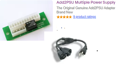

The purpose of the bridge is to ensure that the motherboard has power BEFORE the external power supply has power. This prevents reverse current flow from external power to motherboard which takes place through that 6 pin GPU connector.  Even if  external switched on at same time as motherboard a transient to motherboard thru GPU can melt circuit traces..  Both the GPU and the motherboard can be damaged.  If you are not using a bridge please get one.

You have to be careful to ensure the ground connection is good when using two power supplies.  Did you use a "Y" cable for the 115 / 220 power in addition to the bridge?

Hi
I did not used any "Y" cable because the external PSU was connected to my main PC (motherboard, cpu, etc). The GPU (from old pc) was directly connected to the External PSU's PCIe 6 pin connector. The system (old pc) was connected trough the original PSU (motherboard, cpu, etc.)
Somehow, the first output port of the GPU was not functioning and was not giving signal. Though the first time it was giving so I was worried. The second one does so, I guess it works! And also, I got a Sata to 6-Pin Adapter!
