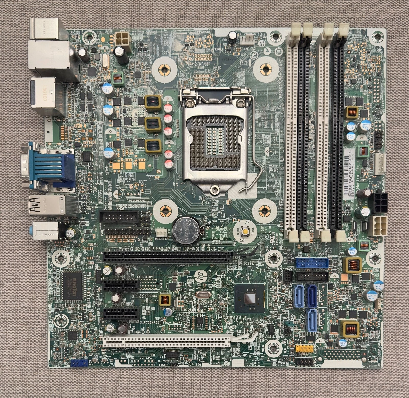

Hello, good time I have a HP EliteDesk 800 G1 SFF main case that has no motherboard except Merlin Rev:A. After connecting to the power supply, the device turns on but does not display a picture. After a few moments, the fans start working at high speed. I downloaded many files from the site, but no change appeared. I searched the site and many friends had the same problem and they all said that no change appeared with the files they were given. If possible, please guide me.

Happy to assist you with your project, but please clarify a couple of things.  You said, quote: "has no motherboard except Merlin Rev:A". Just to check in with you, your HP EliteDesk 800 G1 SFF motherboard looks like this: https://i.ebayimg.com/images/g/UAEAAOSwgrBlo2Hd/s-l1600.webp.  Also, what processor do you have installed, what RAM module(s), and what primary (boot) drive do you use?

But maybe I am running ahead of myself.  You said you couldn't get your PC to boot up properly. Can you get into BIOS?  Did your PC work previously?  What did you do or what changed before it developed the issue? Did you connect all the power supply's power cables: the white 4-pin "PWR CPU", the white 6-pin "PWR CMD", and the white 6-pin "PWR" -see the system board diagram: Camelot800 SFF IPSM.fm.
